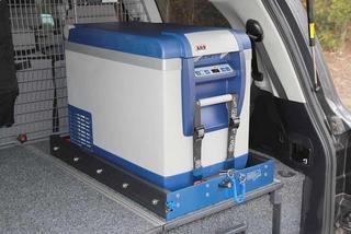

2.) My truck (was) equipped with an AC/DC powered electric compressor type ARB refrigerator/freezer but I removed it last summer since I have become very reliant on the camper's absorption refrigerator and needed the extra storage space in my truck.
Since I have now learned that camping in extreme cold can indeed affect the proper function of my campers absorption type refer, I may consider re-installing the ARB unit in my truck for my trip to Wisconsin in January.

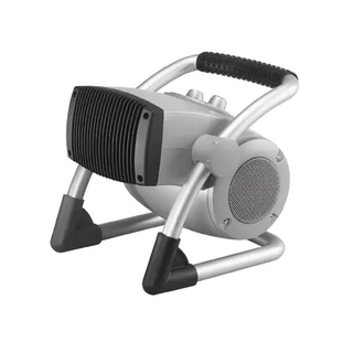

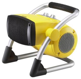

#12 OFFLINE   Electrojake
Electrojake
  • 150 posts
  • Local time: 03:09 PM
  • State/Province or Region:Northeastern US
  • Location:Not so new Jersey
  • Interests:Work is my hobby.
  • Camper Brand:Northstar Arrow-U
  • Truck Make & Model:RAM 3500 Cummins/AISIN
  • Name (Public):Jake
Posted 21 November 2018 - 08:09 PM
The majority of household heaters are limited to 1500 watts maximum energy consumption which will place a 12.5 amp load on a 120 volt AC line.
On low heat they typically will draw 7.5 amps.
The ceramic, forced air unit I use comes in multiple flavors...
You can get it in black, yellow, or gray as a Lasko 675919, Stanley Pro-Ceramic, an Air King 8900, and various Chinese knock-offs.
Amazon.com sells several variety's. Prices range from $39 to $79.
I do not know what the differences are (other than color) but I currently have the Stanley Pro yellow version. It has been in use for many years without any problems.
It is quiet, almost impossible to tip over, adjustable blow angle, comes apart very easily for cleaning, and has proven itself to be very durable. About the only down side is that its rather ugly.
My old Stanley unit runs 24/7 all winter long in my camper. I have it set at 52*F and regardless of the outside temperature it is always 52 inside my camper.
Stanley unit. . .
Air King 8900. . .
