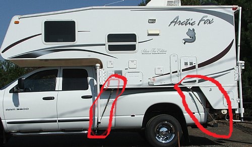

1.) If there is no dropped tail section to the shortbed camper I would just slide the entire unit forward as far as possible toward the front of the truck.
However, if the short bed camper has a tail section (as in the photo below) then you could only slide the camper forward until the tail lights of the truck contact the dropped tail section of the camper, which in my opinion would NOT be an acceptable way to transport the camper.
2.) I'm rather new at this so I can only speak from about 3 or 4 years experience but in short the answer to your question is YES, kind of.
When it comes to modern long-bed trucks & campers the tie-down points are all predictably close.
With short-bed campers and trucks things can vary quite a bit but are always within a reasonable reach.
In your case (a short bed camper on a long bed truck) would create an interesting challenge  :cartwheel: but I'm sure its been done many times before.
There are also camper tie-down point re-locators you can buy, or you can install a second set of tiedown loop brackets on the underside of the camper yourself.
See the link I have posted below...
Tiedown points that are greatly offset from each-other are not usually a problem since tiedown chains are very flexible/adaptable.
If you had to make a long reach at a steep angle (from camper to truck) you could just use longer chains at a steeper angle.
(see picture below)
There is no substitute for good balanced camper-to-truck fitment but center of gravity and tiedown point locations are quite flexible.

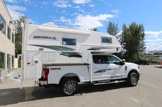

3.) Camper picks. . .
I have a Northstar http://www.northstar...pers-8-5-arrowu and https://truckcamperw...m/inventory/new which are by far the most durable 4 season units I have ever been in.
The Northstar interior's are a bit spartan, they only come in non-slide, and they do run kinda' heavy but they are built like a tank and are absolutely impervious to winter weather. I think of the Northstar equipment as the alter ego of the luxurious Lance units I have been in.
Picking out your perfect truck and camper combo is indeed a difficult task. It took me about 2 years to end up with a Northstar on a RAM, which is funny since I originally set out to buy a NorthernLite on a Ford.
