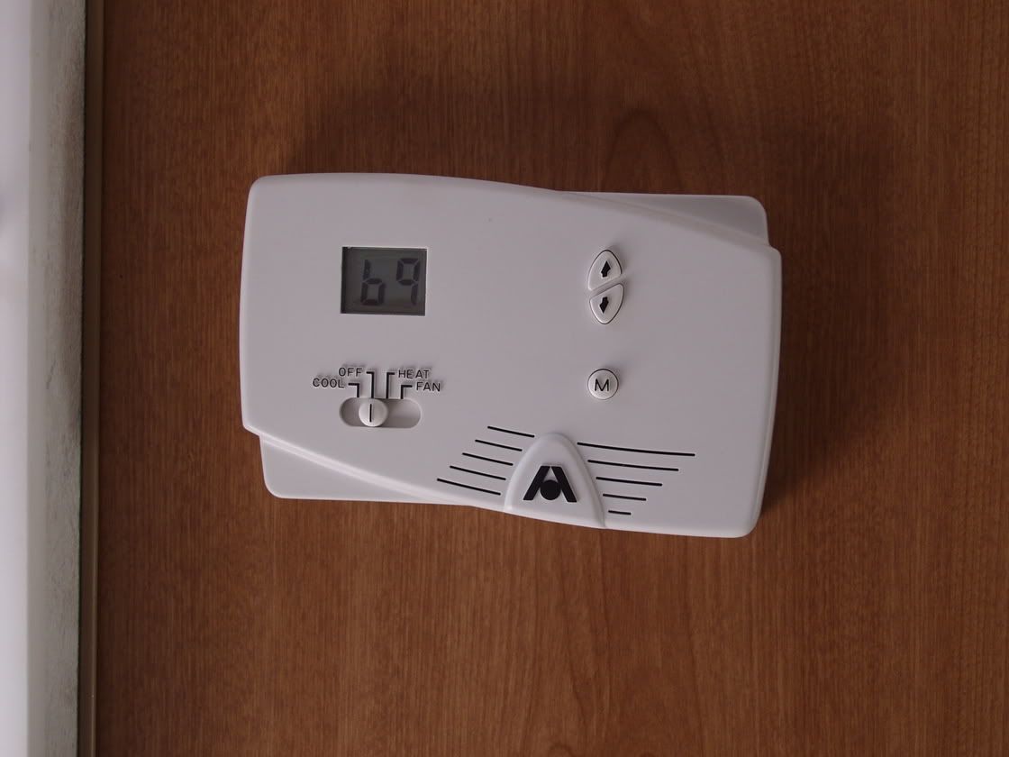

QUOTE (btggraphix @ Jan 3 2009, 01:24 PM) <{POST_SNAPBACK}>
Thanks. And for the record, I can't seem to keep track of my own toys...the camper is an 06, my truck is 05. I'm not even exactly sure of what the cold weather package is...but as poor as my Lance is in the cold, maybe I don't even have that.
Can you post a picture of your thermostat?

Posted 06 January 2009 - 09:06 PM
Gary, my wife seems to be a lizzard as opposed to a penguin! Mooney, I will post a picture....I'm working on some paperwork and will try to sneak outside and snag one.

Here is a picture of the Atwood digital thermostat that comes standard with variable speed furnace:

I took the picture, but haven't copied it to my PC, but no need to....it is exactly like yours. Other than the fact the slider seems to be a bit 'depressed' into it's slot (like someone mashed it in a little) it works great. Glad to know it is there and perhaps I can change out the furnace one fine day.
The external locations of all the appliances are a bit different on the 1191 (HWH is next to the door, then the furnace, then the propane storage, then the fridge - going rear to front)

That thermostat comes with the variable system, sounds like you already have the correct furnace.

OK, now I'm confused...I guess I'll have to pay attention to it more or get a closer look at it; I assumed this camper had it (as the thing was loaded) but to my knowledge, it always sounds the same volume; though it is certainly quieter than the one in my S&S was.

Get out the manual on the thermostat. Put the slider switch in "heat" mode, press the "m" and check your settings. You may be locked in "high" fan mode. You can change all kinds of settings, you can lock out low, high, change set points and do the same for you air. It's full of features, sounds like you might be set up for "high" only.

Nice, thanks Mooney. Like having a corvette but not knowing it has more than one gear. "and I can't get my car out of...second gear, hey!"
